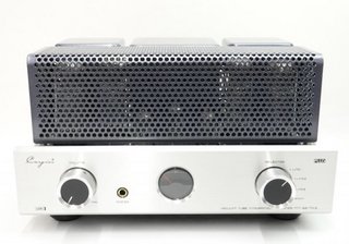

Celui-ci
https://www.easylounge.com/amplificateu ... lver-70290
