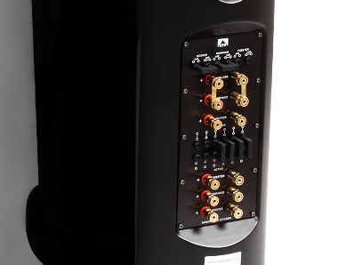

Les caractéristiques de l'enceinte :
Construction type 3 -way High End speaker
Bass reflex cabinet that may be set as a closed box, and a total of three individual bass modes (Room Tuning).
Bass level, midrange level and tweeter level can be adjusted in 2 steps.
With the clever speaker terminal, the speaker can easily be changed into active drive for some or all drivers.
Size: Height: 123 cm, Width: 42,3 cm, Depth: 60 cm
Weight : 69 kg /st
Cross over frequency : 180Hz/2500Hz
Nom. Impedance : 4 ohm
Efficiency : 89dB
Power :
900 W Short term IEC 268-5
450 W Long term IEC 268-5
Tweeter : Visaton ceramic tweeter. Magnetically shielded. Weight 1kg
Midrange : Thiel & Partner C173N-T6-90, Neodymium magnet Weight 3kg
Woofer 2pcs 10” SEAS Aluminium cone, aluminium frame, High flow basket, 3kg magnet. Weight 4kg.
Connections and settings
Gold plated tri-wiring. Active/Passive drive
Bass reflex, can be set to closed box (Room Tuning)
