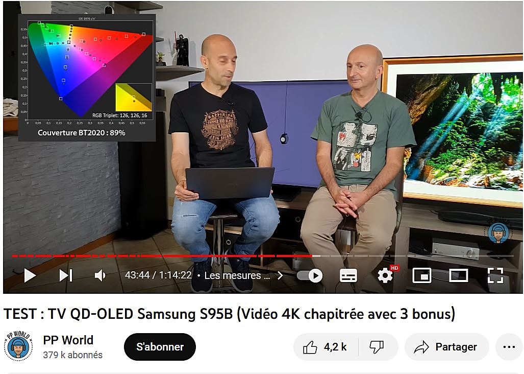

... non, les 90% ont été mesurés par différents sites et testeurs sur le mode image le plus neutre et fidèle, Filmmaker Mode ...
Rec 2020 xy
86.93%
Rec 2020 uv
91.76%
The Samsung S95B has an exceptionally wide color gamut. It has full coverage of the DCI-P3 color space used by most current HDR content, including most UHD Blu-rays. It also has excellent coverage of the wider Rec. 2020 color space, much better than the LG G2 OLED, but the tone mapping is a bit off with saturated colors, especially green and cyan. Compared to the Sony A95K OLED, it has worse tone mapping, so the Sony preserves details better, resulting in a more life-like image.
https://www.rtings.com/tv/reviews/samsung/s95b-oled
... 76% c'est pas top du tout, c'est le max de ce que les Woled à dalle LG Display peuvent atteindre, on est loin des 100% ... :cry:
Dans ce test, la mesure du BT2020 est de 89% ...
https://www.youtube.com/watch?v=UIoO1M85xJw
FZ26
